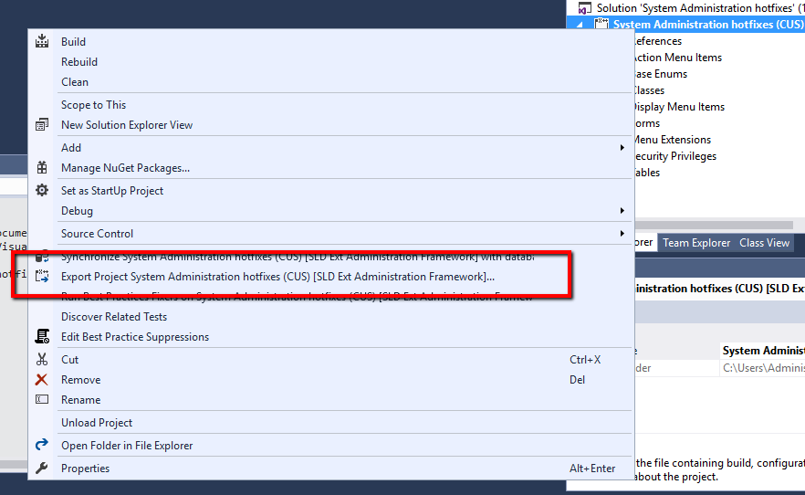

Step-2 Add some elements in the project and right click on the project you will find the export option on Menu option.
Reference Screenshot

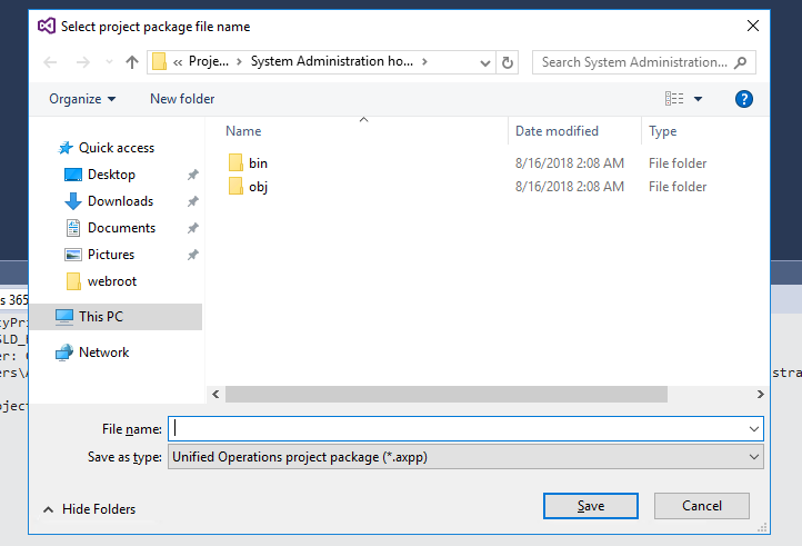

Step-3 Provide the path where you want to save the Export project which will in the form of *.axpp.

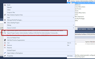

Step-4 Now click on save.. export will take 2 to 3 minutes, exporting time duration vary on number of the elements.

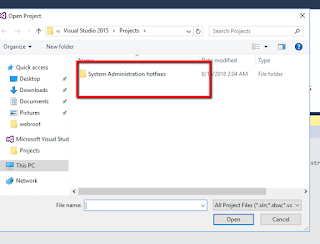

Step-7 When you click on import project, A popup will appear. provide the path of the project you want to import.

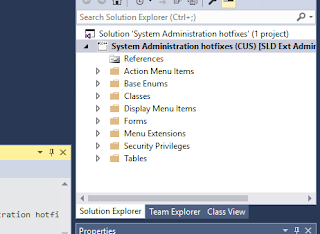

Step-8 once project imported, Visual studio show the complete elements which are part the project.

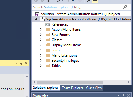

Step-10 Now navigate to File menu and open the project. (You will find the recently imported project on default path of Visual studio)
Step-11 Now verify your all elements and check model if it was not exists before import. In my case module and sub-model were not exists.
