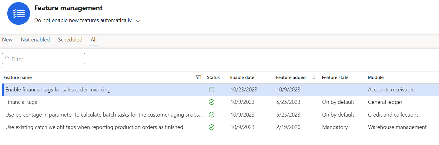

There is a new feature for Financial tags on Sales orders.
https://learn.microsoft.com/en-us/dy.../financial-tag
This feature can be enabled under the feature management.
