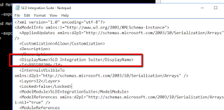

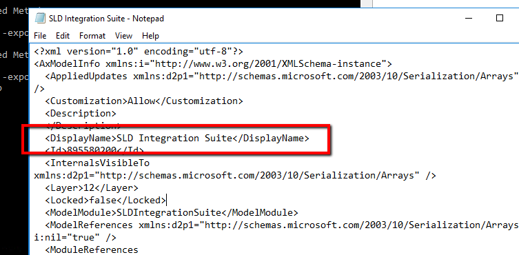

Important
You can find the model name in Descriptor file in the tag of Tag
