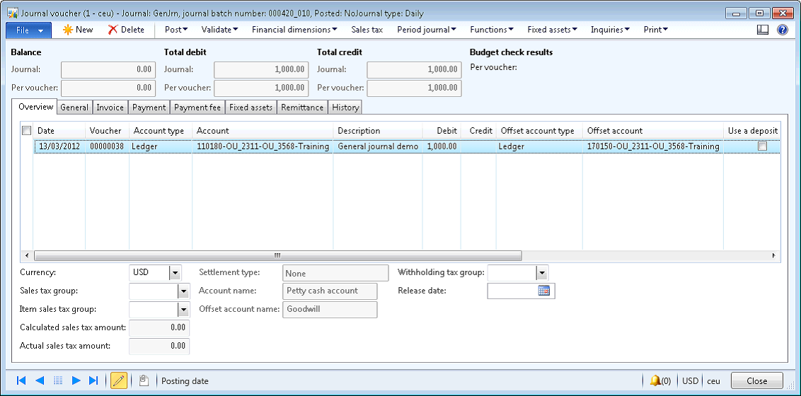

5. Run the job and check the results by opening General ledger | Journals |
General journal:
6. Click on the Lines button to open journal lines and notice the newly created line:
