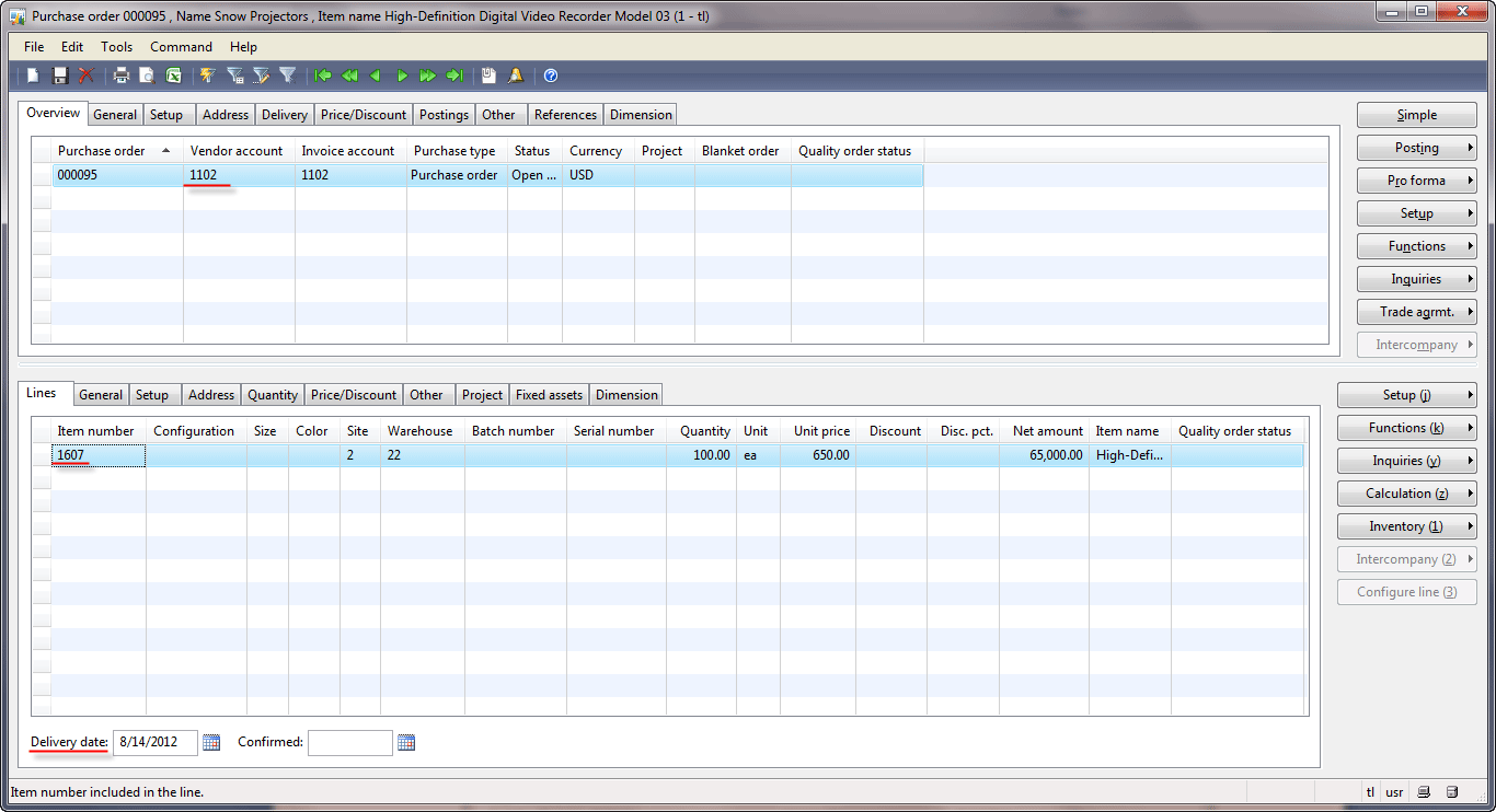

  1. Go to Accounts payable > Common Forms > Purchase Order Details. The Purchase order form opens.
  2. Create a new purchase order clicking Ctrl+N. The Create purchase order form opens. Select the 1102 vendor in the Vendor account field. The Transfer vendor information box appears. Click Yes. Click OK. The purchase order header is created in the Purchase order form.
  3. In the Purchase order form, in the lines area select the 1607 item in the Item number field. The Site, Warehouse, Quantity, Unit, and Unit price fields are filled in automatically from the item setup. Set Delivery date to today. The Purchase order form has the following view:
    Purchase order form

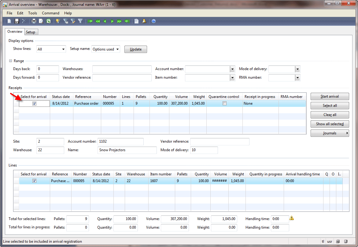

  5. Go to Inventory management > Periodic > Arrival overview. The Arrival overview form opens. Select the Select for arrival check box for the created purchase order.
  6. Click the Start arrival button. An arrival journal is created. The “Journal 001689_117 of the type item arrival created” message appears. Double-click the message or go to Inventory management > Journals > Item arrival > Item arrival. The Location journal form opens, find the last arrival journal. Click the Lines button. The Journal lines form opens. Click the Functions > Pallet Id button for the first line and repeat this action for all lines. As a result, the Journal lines form will have the following view:

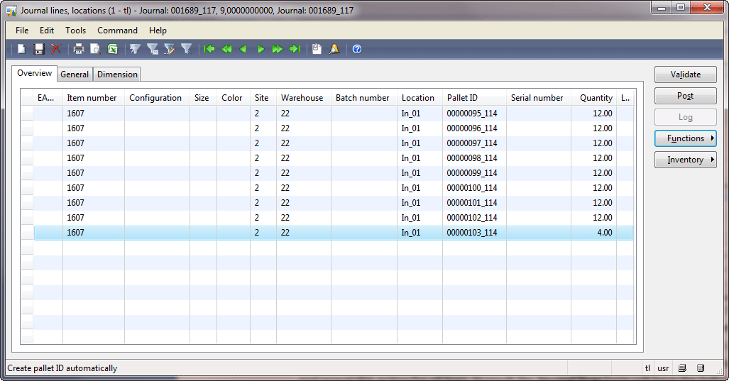

    Journal lines form (Arrival journal)
  7. We can see that the total item quantity of 100 is divided by the pallet quantity of 12 items and the pallet numbers are calculated. The pallet quantity is set up on the item (Inventory management > Common Forms > Item details > find the 1607 item > Setup tab > Warehouse management field group > Pallet quantity field). Unfortunately, it is impossible to set up different pallet quantities for different pallet types. When we post the arrival journal, the system automatically finds the destination location and creates the pallet transport for each pallet. A pallet transport is an instruction to the forklift driver to deliver the item from the inbound dock to the destination location. Click the Post button in the Journal lines form. The “Journal has been posted” message appears.

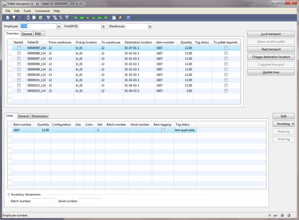

  8. Pallet transports are created. When we finish, these transported items will be registered in the warehouse. Go to Inventory management > Common Forms > Pallet transports. The Pallet transportsform opens.
    Pallet transports form
  9. Click the Start transport button. The Start transport form opens. Click OK. As a result of this operation, the Started check box in the Pallet transport form is selected. Now the Complete transport button is available. Click the Complete transport button. The pallet transport disappeared from the Pallet transport form. As a result, the items will be registered in the destination dimension (i.e. in a certain location on a certain pallet). (To check this, in the Purchase order form click the Inventory > Transactions button. The Transactions form will have the following view. If you don’t see some dimensions in the Transactions form, enable them with the help of the Inventory > Dimensions display button). Repeat this step from the beginning for all pallet transports.

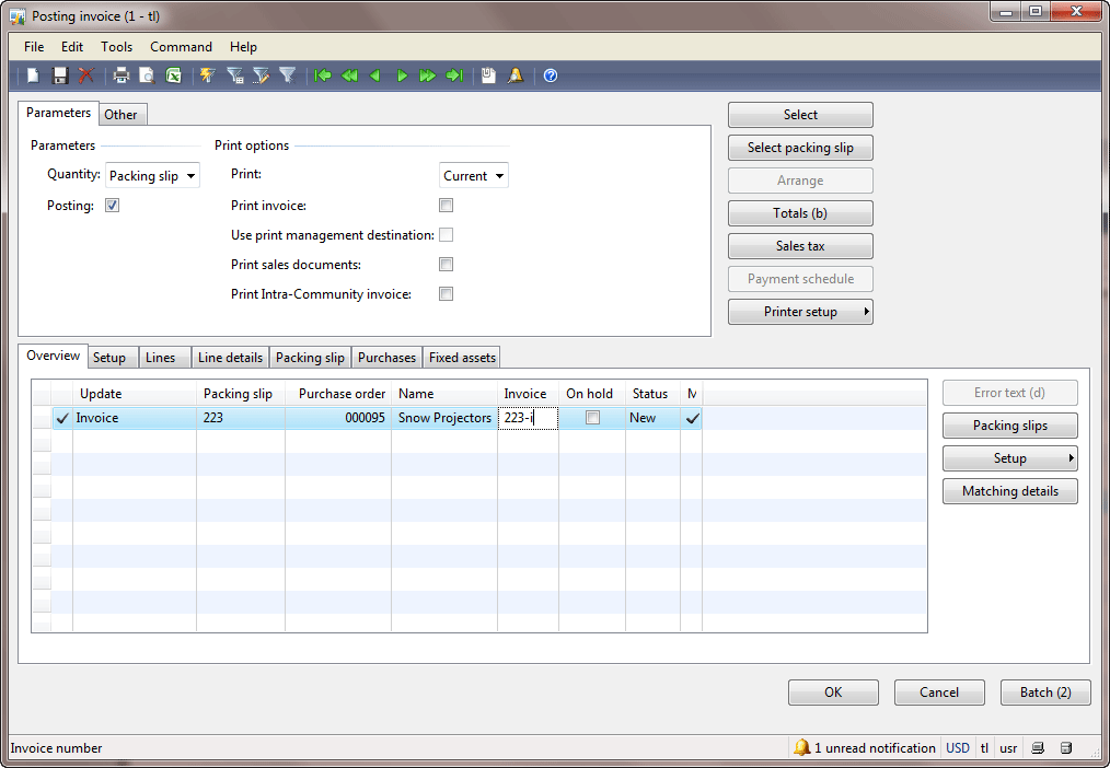

  11. Now we can post an invoice. We assume that the vendor sends us the invoice and we will sign it. The invoice document guarantees that the Company will pay for the delivered items. Click the Posting > Invoice button. The Posting invoice form opens. Fill in the Invoice field with, for example, the 223-i value (this value is taken from the invoice document sent by the vendor) and click OK. The invoice will be posted.Posting invoice form
    If we open inventory transactions, we will see that the receipt status changed from Received to Purchased: in the Purchase order form, click the Inventory > Transactions button. The Transactions form will have the following view. The general ledger transactions are also generated since the company agrees to pay for the delivered items. In the Purchase order form, click the Inquiry > Invoice. The Invoice Journal form with one invoice journal opens. Click the Voucher button to see the general ledger transactions. The Voucher transactions form has the following view.

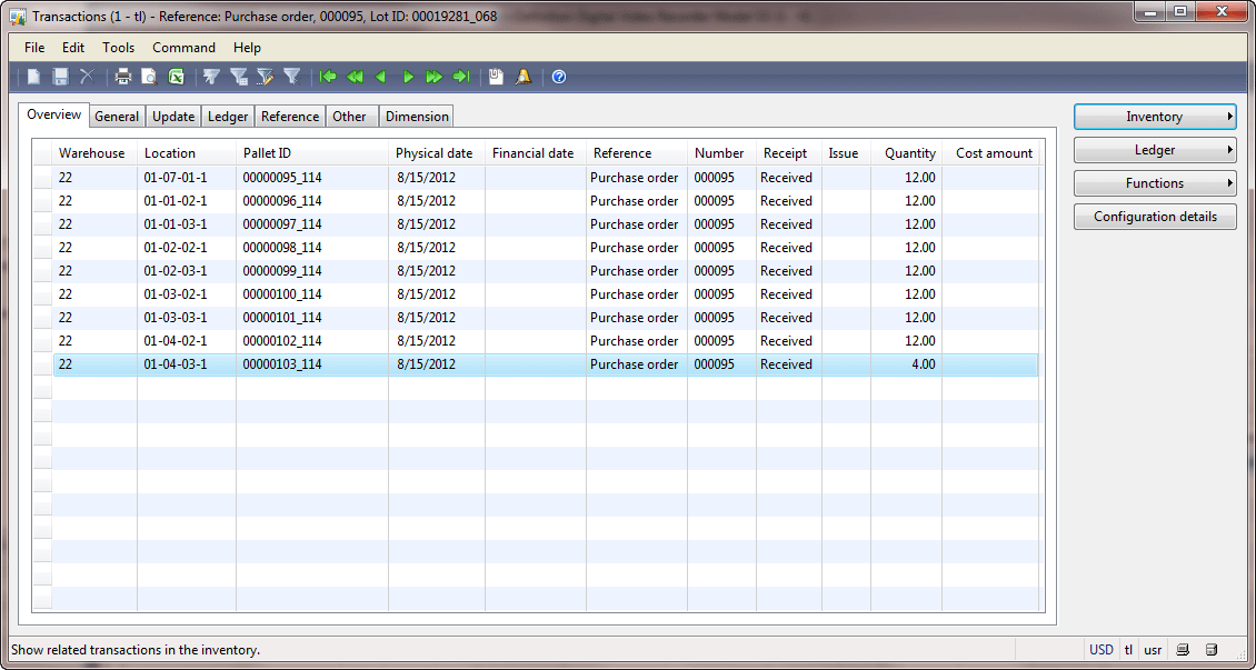

The Purchase Manager asks the Inventory Manager about the dimension where the broken items are found. Let’s check what dimensions are used to store the purchased items. Open the Purchase order form if it was closed and find the created purchase order. In the line area, click the Inventory > Transactions button. The Transactions form opens. Activate the Pallet and Location dimensions by clicking the Inventory > Dimensions display button. In my case the Transactions form will have the following view:
Transactions form (Purchased)
In this form, we can see the dimensions where the items were stored. We assume that the Inventory Manager finds 10 broken items in the 01-01-03-1 location, 00000097_114 pallet. Let’s return these items to the vendor. Note that we cannot specify exact items to return because the 00000097_114 pallet has more than 10 items (it contains 12 items). To specify the exact item, an additional Number Sequence dimension should be activated for the item. In this case each item on the pallet will have a unique number. The 1607 item uses the N-WLP dimension group (Inventory management > Common Forms > Item details > Find the 1601 item > General tab > Dimension group) that doesn’t have the Number Sequence dimension active. In this case we assume that during the picking process the warehouse worker finds the broken items on the pallet by himself.

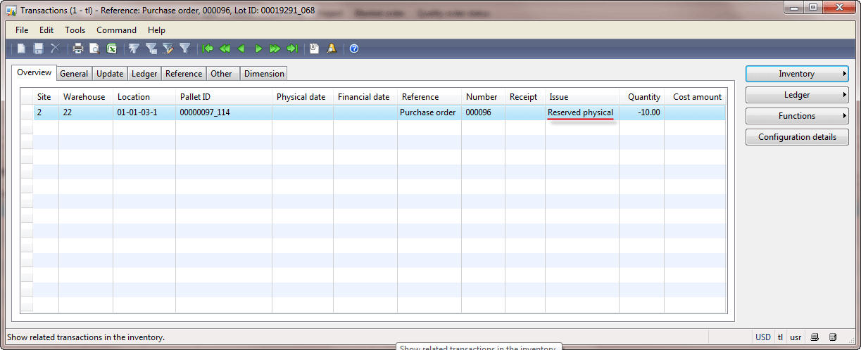

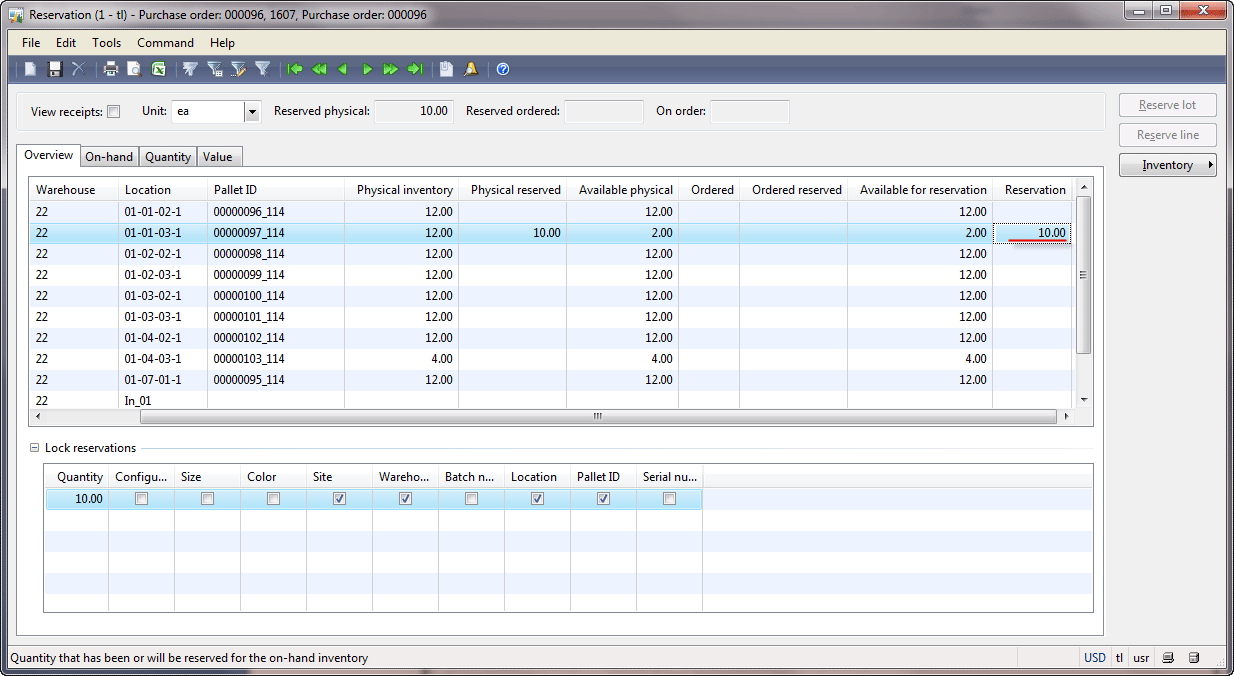

  1. In the Purchase order form, in the lines area, click Inventory > Reservation. The Reservation form opens. Enable the dimensions in this form by clicking Inventory > Dimensions display button > Select Warehouse, Location, and Pallet dimensions > click OK.
  2. Find the dimension where the broken items are: 01-01-03-1 location, 00000097_114 pallet.
  3. Fill in 10 in the Reservation field. Save the line. 10 items in this dimension will be reserved. Note that this dimension has 12 items (10 broken and 2 good). Since we can’t reserve specific items, the Warehouse Worker should be careful when selecting items from this dimension for the return order (he or she should select only the bad items). Note that if it is required to reserve specific items, the Serial number dimension must be enabled for this item through the inventory dimension group. The Reservation form will have the following view:
    Reservation form
  4. Please make sure that the items are reserved. In the lines area of the Purchase order form, click the Inventory > Transactions button. The Transactions form opens. We can see that an inventory transaction with the status Reservedis available. Just for information:
    • The Reserved physical status means that the reserved qty is physically available in the dimension.
    • The Reserved ordered status means that the quantity is reserved but the dimension doesn’t contain the required items. When items will be transferred to the dimension, the status will be update to Reserved physical.
    Transactions form (Reserved)

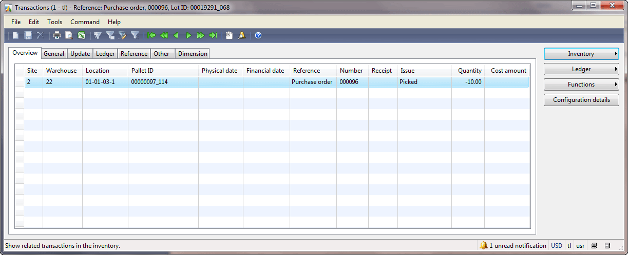

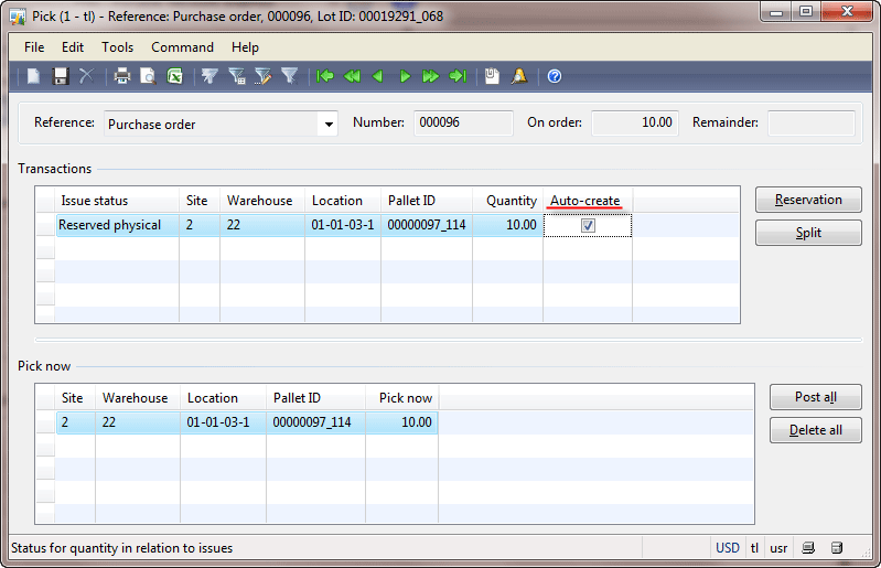

  5. Unfortunately, it is impossible to create a picking task for a purchase order line (or for an output order that can be created for the purchase order line). So, we cannot use the Picking form (Inventory management > Common Forms > Picking routes). We assume that the Purchase Manager calls the Warehouse Worker and asks him to perform the picking task: pick the broken items from a specific location and pallet, transfer the broken items to the outbound location, and inform the Purchase Manager about the operation being completed. The Warehouse Worker receives this in an informal form from the Purchase Manager, because we can’t create the picking instruction document in Microsoft Dynamics AX for the returned items. When the Warehouse Worker completes the picking task and informs the Purchase Manager, she or he does the following: in the lines area of the Purchase order form, click the Inventory > Pick button. The Pick form opens. Click the Auto-create check box. As a result, a new line appears in the Pick now area.Pick form
    Click the Post all button. The items will be updated to the Picked status.
  6. Please make sure that the items are picked. In the lines area of the Purchase order form, click the Inventory > Transactions button. The Transactions form opens. We can see that the inventory transaction status is updated from Reserved to Picked.Transactions form (Picked)
    Note that in the system we don’t record where the warehouse worker delivers the broken items to. The Microsoft Dynamics AX only knows that the broken items were picked from a certain dimension. Also, we will not specify in which vehicle the broken items will be delivered from the warehouse gate to the vendor. Vehicle or truck management is not implemented in Microsoft Dynamics AX 2009. Each pallet contains information about the location where the pallet is. But the pallet location is only updated when the Pick form is used. So if we go to Inventory management > Setup > Inventory equipment > Pallets > find the 00000097_114 pallet, the Location field will contain the 01-01-03-1 location not the outbound location.

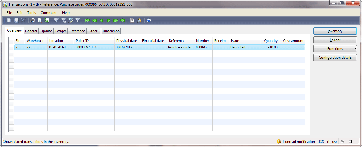

  7. We assume that the items are loaded to the truck and delivered to the vendor. When the items are delivered, the Purchase Manager posts, prints, and sends the Packing slip document for the vendor to sign. The packing slip document is a guarantee that the vendor receives the broken items. In the Purchase order form, click the Posting > Packing slip button. The Posting packing slip form opens. Enter a packing slip number, for example “Return 1” and click OK. The packing slip is posted.
  8. Please make sure that the items are deducted from the warehouse. In the lines area of the Purchase order form, click the Inventory > Transactions button. The Transactions form opens. We can see that the inventory transaction status is updated from Picked to Deducted.
    Transactions form (Deducted)

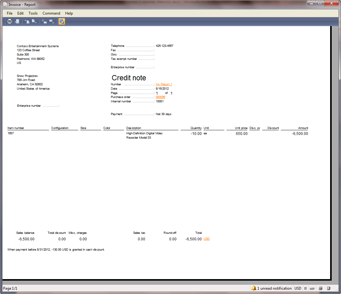

  9. The Purchase Manager posts, prints, and sends the invoice document for the vendor to sign. This document confirms that the vendor must pay (return) some amount of money for the broken items. In the Purchase order form, click the Posting > Invoice button. The Posting invoice form opens. Fill in the invoice number, for example, “Inv Return 1” to the Invoice field. Click OK. The invoice is posted.

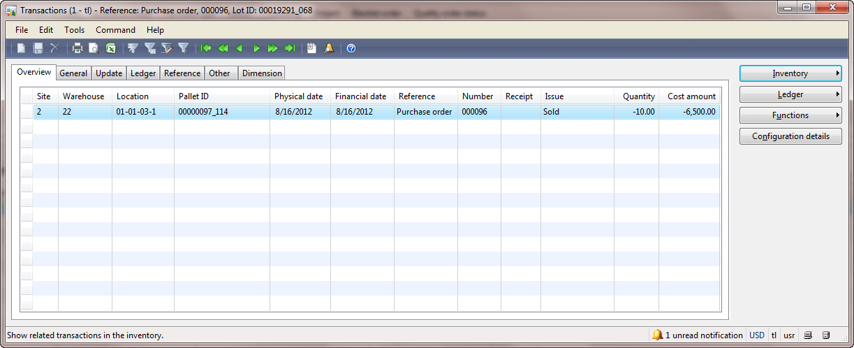

  10. Please make sure that the items are sold from the warehouse. In the lines area of the Purchase order form, click the Inventory > Transactions button. The Transactions form opens. We can see that the inventory transaction status is updated from Deducted to Sold.
    Transactions form (Sold)
Note that the invoice document has the “Credit note” title. Print the invoice to the screen to check it: Purchase order form > Inquiries menu button > Invoice button > the Invoice Journal form opens > Preview/Print menu button > Original preview button. The invoice has the following view.

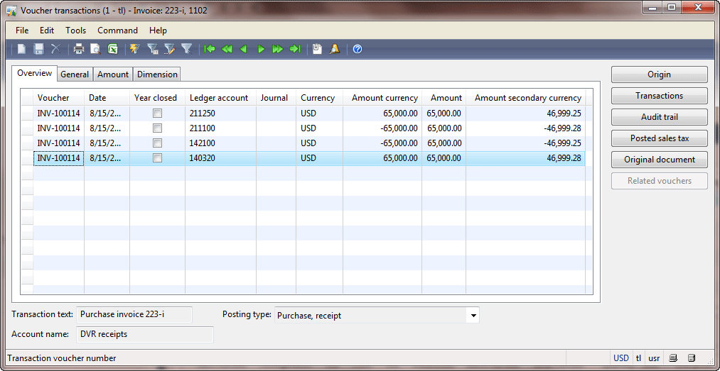

To view the general ledger transactions that were generated during the invoice step, click the Voucher button in the Invoice Journal form.
Transactions for the 211250 and 142100 general ledger accounts are the reverse ones for the packing slip transactions. (You can view the voucher for the packing slip and make sure that the opposite transactions are there.) The transactions have the following view:

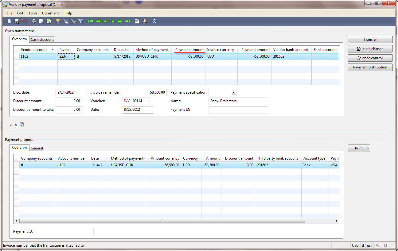

Now the company pays for the delivered items. We will check how settlement works. Let’s create a payment to the vendor. You can find additional information about the payment process in this training lesson.
  1. Go to Accounts payable > Journals > Payments > Payment journal. The Journal form opens.
  2. Create a new line. Select “APPay” in the Name field. Save the line.
  3. Click the Lines button. The Journal voucher form opens.

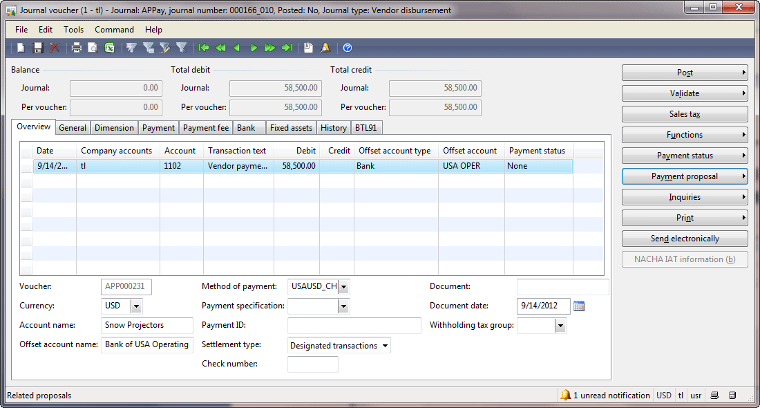

  4. Click the Payment proposal > Create payment proposal button. The Vendor payment proposal form opens. Click OK. The Vendor payment proposal form will have the following view:Vendor payment proposal form
    We can see that the sum for the broken items was already deducted from the payment amount. Click the Transfer button. The Transfer payment proposal to journal dialog opens, click OK.
  5. The Journal voucherform will have the following view:
    Journal voucher form (Payment)
The amount is decreased because Microsoft Dynamics AX automatically settles vendor transactions from the purchase and return orders. Settled amount means that the amount is closed, i.e. paid.

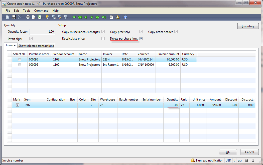

  1. Create a new purchase order. Go to Accounts payable > Common Forms > Purchase order details. The Purchase order form opens. Click Ctrl+N. The Create purchase order form opens, select the 1102 vendor in the Vendor account field. The Transfer vendor information dialog box appears. Click OK. Click OK. The purchase order header is created.
  2. In the header area of the Purchase order form, click Function > Create credit note button. The Create credit note form opens.
  3. For example another 3 items were broken. Select the purchase order with the purchased item. In the line area, fill in 3 in the Quantity field. Unfortunately, we can’t specify the location and pallet dimensions for the broken items on this step (We should do this manually with the help of the Reservation form). Click OK.
  4. The purchase order line will be created with the correspondent item, dimensions, quantity, and unit price.Purchase order form

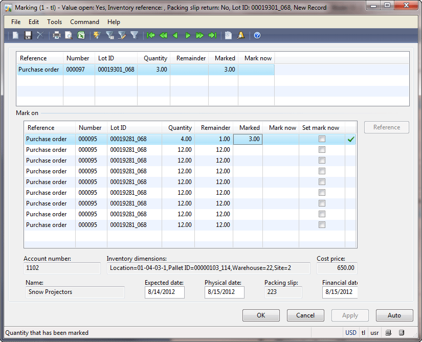

    Microsoft Dynamics AX also automatically reserves the item in the warehouse and marks (settles) an inventory transaction from the purchase and return order. Unfortunately, we can’t set up the broken item inventory dimensions (pallet, location) in the Create credit note form. So Microsoft Dynamics AX automatically reserves and marks the first 3 items from the warehouse. If we click the Inventory > Marking button, the marking will be shown.
    Marking form
    Automatic marking selects the first 3 items from the inventory. But the broken items can be in another dimension, so manual unmarking and marking should be done (during the unmark process the items are also unreserved automatically).
Then, the purchase order with negative quantity is handled in the same way as we have studied.

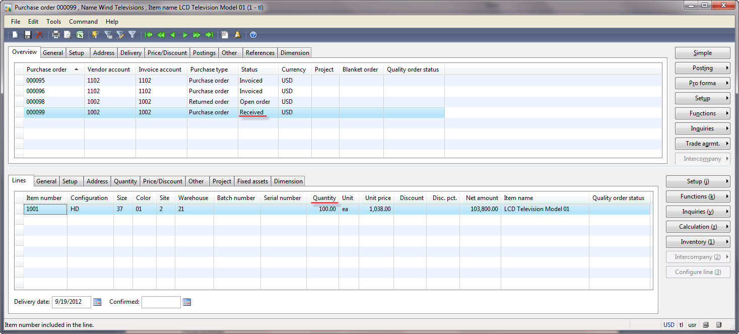

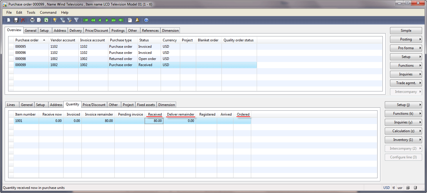

  3. The vendor delivers 100 items, but 20 of them are broken and we refuse to accept them. We post only 80 items in the system. Click Posting > Packing slip > in the Parameter field group select the All value in the Quantity field > fill in 123 in the Packing slip field > go to the Lines tab > fill in 80 in the Update field > click OK. The items will be posted as received. Note that the 1001 item does not use the warehouse management so it is not required to go through the arrival and registration process.
  4. To check the posting result, go to the Quantitytab. We can see that 80 items are received and 20 remain ordered (backordered).
    Purchase order form, Quantity tab

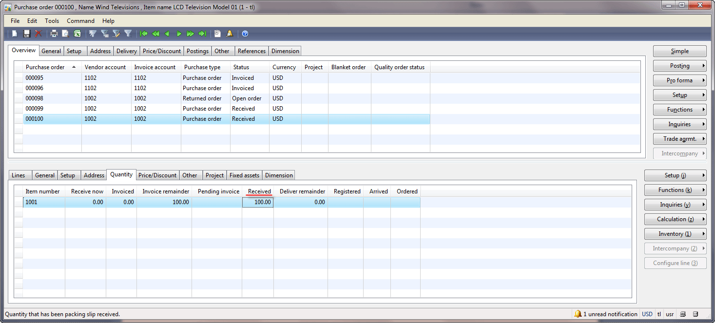

  5. If the company decides to cancel the refused quantity,  you need to click Functions > Deliver reminder. The Update remaining quantityform opens.Update remaining quantity form
    Either enter 0 in the Deliver reminder field and click OK or click the Cancel quantity button. The ordered quantity will be canceled.
  6. If we look at the Quantity tab, we will see that there are no deliver reminders and ordered quantity.Purchase order form, Quantity tab
    Note that the Lines tab contains the ordered quantity (it is for the information purpose) and the purchase order status changed from Open order to Received(because all ordered items are received).

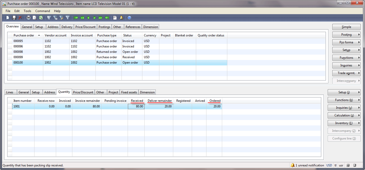

  3. The vendor delivers 100 items. The Purchase Manager posts 100 items in the system. Click Posting > Packing slip > in the Parameter field group, select the All value in the Quantity field > fill in abc in the Packing slip field > go to the Lines tab > make sure that the Update field contains the value 100 > click OK. The items will be posted as received. Note that the 1001 item does not use the warehouse management so it is not required to go through the arrival and registration process.
  4. To check the posting results, go to the Quantity tab. We can see that 100 items are received.
  5. The Purchase Manager was informed that 20 items are broken. He or she decides to send these items back to the vendor. The following should be done in Microsoft Dynamics AX. Fill in -20 in the Receive now field on the Quantity tab.

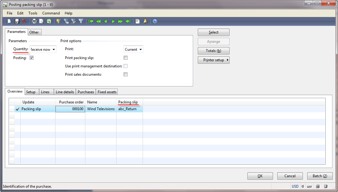

  6. Click Posting > Packing slip > in the Parameter field group, select the Receive now value in the Quantity field > fill in abc_Return in the Packing slip field > go to the Lines tab > make sure that the Update field contains -20 > click OK. The items will be posted as received. Note that the 1001 item does not use the warehouse management so it is not required to go through the shipment process.
  7. To check the posting result, go to the Quantity tab in the Purchase order form. We can see that 80 items are received and 20 remain ordered (backordered). The purchase order status changed from Received to Open order.Purchase order form, Quantity tab
    This is actually the same as when we post just 80 items. But in this case more inventory transactions are created. Click the Inventory > Transactions button. We can see that posting negative quantity in a packing slip generates three transactions. Note that Microsoft Dynamics AX always generates the Purchased and Sold transactions (i.e. a financial update) when some adjustment with quantity occurs.
    Transactions form (Packing slip)
  8. Since 20 items remain ordered, the Purchase Manager can cancel this quantity clicking Functions > Deliver reminder function.
