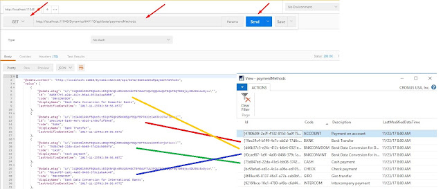

5. Let's try to use GET and compare data with NAV. In NAV Entity is Page - 5486 "Payment Methods Entity".

Now I am comfortable with JSON, you can choose other forms based on your comfort and assigned value to - code and description. The code is code in API and Description is displayName in API.
In postman select the Body tab, select raw and you can select any of 7 formats. I will select JSON and enter values for both parameters and then click send.
** Just to remember all these are case sensitive.
7. Let's check data in NAV table. Here is what we got in NAV using the POST.
