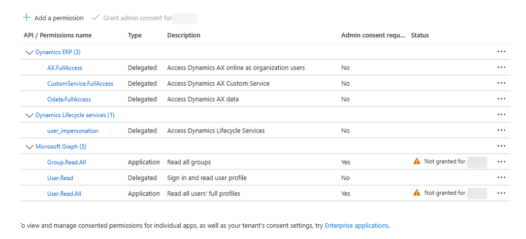

b) add the following API permissions to the App registration:
Grant above permissions.
