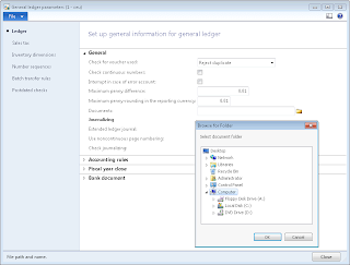

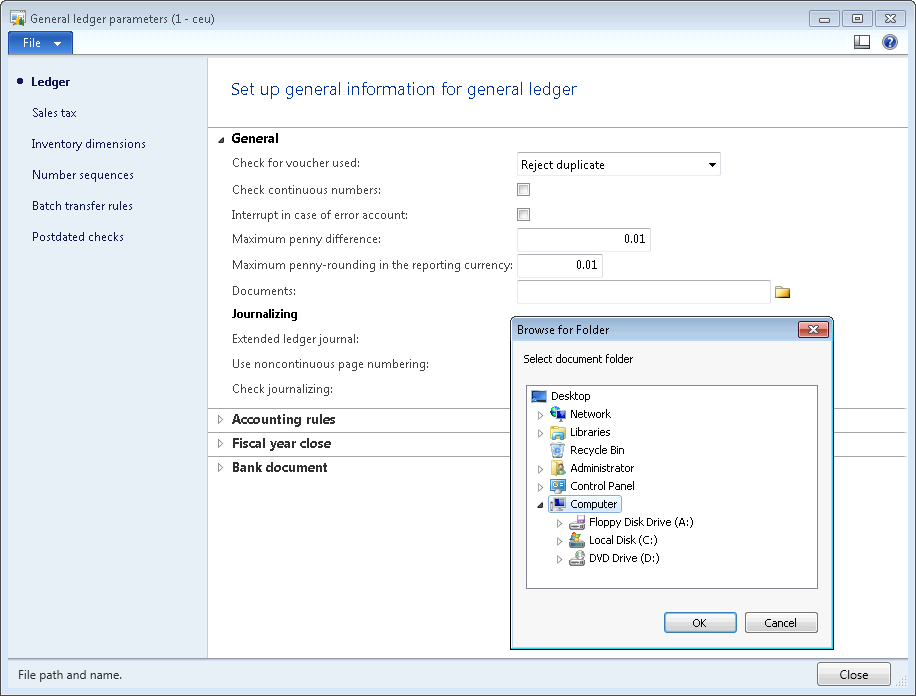

4. To test the results, open General ledger | Setup | General ledger parameters, and notice the newly created Documents control, which allows you to select a folder:
