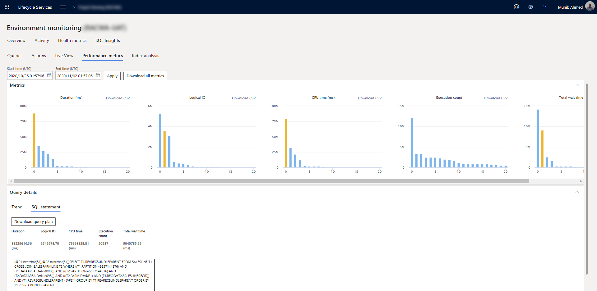

Under the Environment monitoring > SQL insights > Performance metrics.
You can find some slow queries and how they are affecting the environment over time.
I found that SalesLine table was missing an index for Revenue recognition.

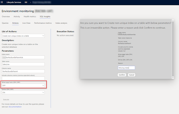

I raised a support ticket but was asked to create a non-unique index on the table via LCS.
Go to Environment monitoring > SQL Insights > ActionsSelect "Create non-unique index on a table".
Turn of the "Allow page locks".

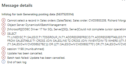

I got an error after I did the above with batch jobs. I had to restart the batch service in LCS to fix the problem.
This is the error I got with batch job to post the sales invoices.
Refer to Microsoft Docs page on this. Typically you want to do this as part of your development but that would cause outage and delay the whole process. In this instance, I tried the above and got past the problem.
https://docs.microsoft.com/en-us/dyn...index-on-table
Note that there is a drop query. So, take note of the index name you created. Then you can delete it afterwards.
