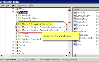

Odd because the first 8 characters of the log name are in the word Microsoft and there are already two other event logs starting with the name Microsoft.
Some searching with the old internet took me to the following post…
http://blogs.msdn.com/b/emeadaxsuppo...rror-2769.aspx
They offer a good description to the why and how to get around the issue by renaming the exisiting logs in the registry while you run the setup. Below are screen shots of the Registry entries, as always ensure you know what your doing if you go into the registry and make appropriate backups …
