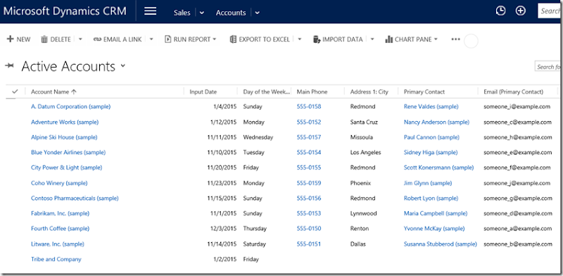

This blog is inspired by a forum post I read where someone asked to display the day of the week in a CRM view. Unfortunately, I cannot find the request now but it is possible (and without code).
In the above, the Input Date is the date we want the date for and the Day of the Week shows the correct day.

Once all of this is done it works like a treat, with the day value being set on the saving of the record. It is then a case of adding the Day of the Week field to the view you want to see it in.
