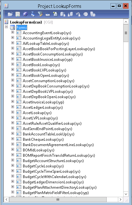

Let's say we need to find all the forms that contain 'lookup' word in the end of their names. Easy? Yes, it is! You can go directly to the SysModelElement table and work with it as with any other table: Ctrl-G to switch grid filter, 11 for Form element type, then *lookup in the name, and that's it.
This is rapid way to know the objects names but it is not possible to jump to them in AOT. Here we go with the second option. Just create a new project and filter criteria Element type name and Name for the objects.
Simple, fast and will keep the search results for future recalls.
