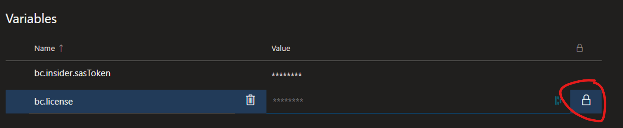

You are probably aware on how “secrets” work in AzureDevops. In a way, it’s simple: you can create variables, and store the value of the variable as a secret or not, simply by tapping the “lock” when creating a variable.
To share variables over multiple repos, you can create a variable group, and use that variable group in multiple pipelines.

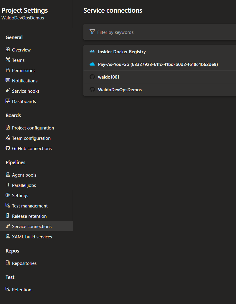

If you ever want to delete/disable access to this subscription, do know it has basically created a service connection, which you can find in the project settings:
