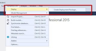

Step-1 Open Visual studio and click on Dynamics365 Menu and select create deployment package from the deploy menu item.

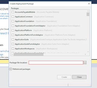

Step-2 Select your model and set the output path of the model and click OK.

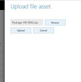

Step-7 click on Add file button to upload your deploy-able package.
Step-8 Now click on browse and select package then click on uplaod.

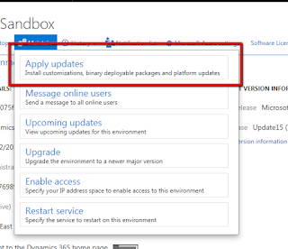

Step-11 Now click on Maintain and select apply update.
Step-12 Select your package and click on apply.
