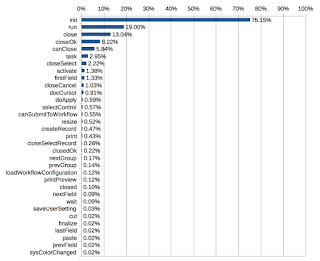

Today I am going to analyse form and datasource methods in standard AX application and find the most and the least overridden.
Form
Overridden rate is calculated as the ratio of the number of forms, where a method is overridden, to the total number of forms.
What does the diagram say?
Not surprisingly, init method is almost always overridden. run, close and closeOk methods are often overridden. All other methods are rarely overridden.
The following methods are never overridden in standard application:

This standard application statistics reflects what is usually overridden by a developer on a regular project:
- init, run, close methods on a form
- init, active, executeQuery, write methods on a form datasource.
