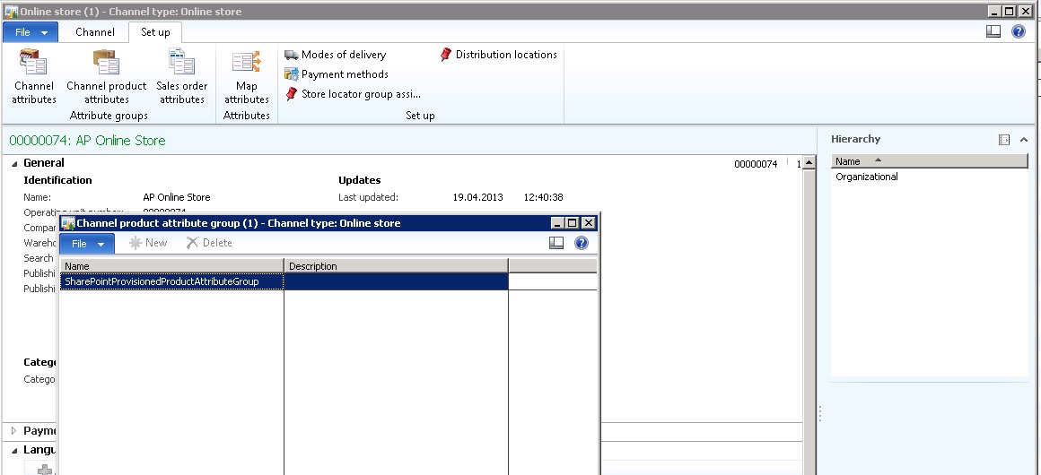

2. On the online store form, on the Action Pane, on the Set up tab click Channel product attributes, then add SharePointProvisionedProductAttributeGroup group (which contains Image attribute).

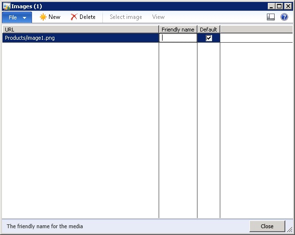

3. On the catalog detail form choose the category hierarchy, select the product from the list, click Attributes under the Products FastTab area. Under Channel media find attribute Image, then click Edit.
In the URL field you can put relative path (like Products\YourImageName) or full path to image with pubic access.
So, after the catalog and online store are republished, images are deployed to the retail publishing site.
