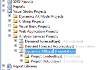

Once the Wizard window is closed, just find your project in the node of Analysis Services Projects and delete it.

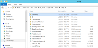

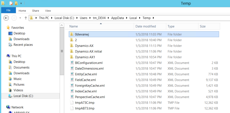

Then find a recently created folder in your TEMP directory; this one must contain your recently added artifacts, say, financial dimensions as depicted.
Here we go.
Now just import this particular project back to AOT, and run the Wizard again to deploy the projects.
