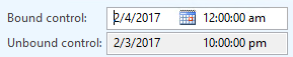

Case 1. Set a value to Unbound control
Assume that Unbound control value is updated in modified method of Bound control like this:
UnboundUtcDateTimeEdit.dateTimeValue(EcoResDateTimeValue.DateTimeValue);
When today is set into Bound control, Unbound control has 2 hours difference:
Why? Because the user time zone is GMT+2 and table field value is saved in UTC time zone, so EcoResDateTimeValue.DateTimeValue field has "2/3/2017 10:00:00 pm". The same value is presented in Unbound control.
The user time zone must be applied to UTC field value to display correct value in Unbound control:
DateTimeUtil::applyTimeZoneOffset(EcoResDateTimeValue.DateTimeValue,
DateTimeUtil::getUserPreferredTimeZone()));

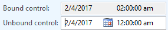

Case 2. Store a value from Unbound control
Assume that utcDateTime table field is updated in modified method of Unbound control like this:
EcoResDateTimeValue.DateTimeValue = UnboundUtcDateTimeEdit.dateTimeValue();
When today is set into Unbound control, Bound control has again 2 hours difference:
Why? The value from Unbound control "2/4/2017 12:00:00 am" is treated as UTC time zone value in EcoResDateTimeValue.DateTimeValuefield. The user time zone is applied by kernel to UTC time zone field value, so Bound control has "2/4/2017 02:00:00 am".
The user time zone must be removed from control value to get UTC time zone value, which can be set to table field:
DateTimeUtil::removeTimeZoneOffset(UnboundUtcDateTimeEdit.dateTimeValue(),
DateTimeUtil::getUserPreferredTimeZone());
