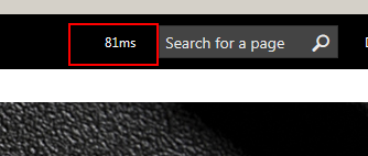

But what happens if you add "&debug=develop" after the last character in the URL, like
https://YourNameHere.dynamics.com/?c...&debug=develop
After the page loads again a small number appears next to the Search box

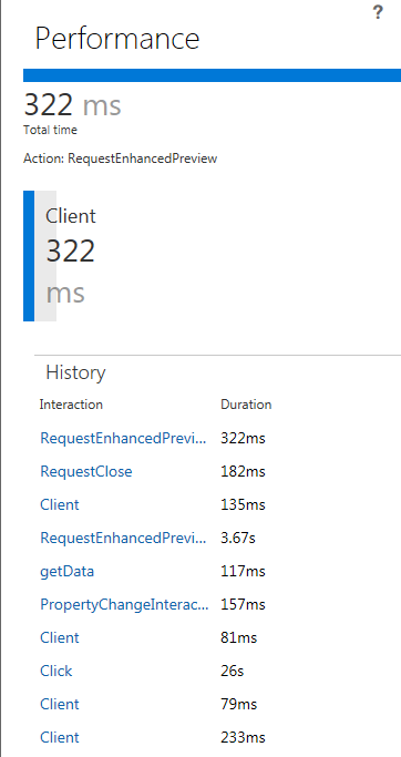

Left click the number and a performance pane pops up to the right where the stack is presented

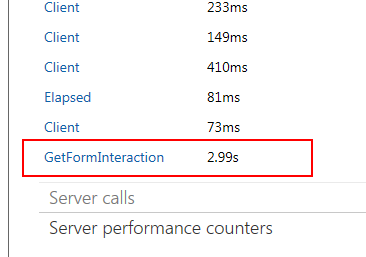

You are able to drill-down if you click one on entries in the stack to get more information regarding the elapsed time
So, a short but effective start off to digging into the end-users performance challenge simply by adding a small snippet after the URL.
