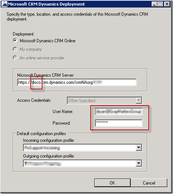

Email Router
If you are running an older version of the email router update to the appropriate 32 or 64 bit version found here.
http://www.microsoft.com/en-us/downl....aspx?id=42272
Install and reboot.
To reconfigure your Email Router:
1. Change the Server URL  from dev.crm.dynamics.com to disco.crm.dynamics.com
2. Change the User Name and Password to new a new Office 365 account
Then under Configuration Profiles Set the Outgoing Access Credentials to match the Office 365 Credentials used above.
Now
  1. Publish your changes
  2. Load Data
  3. Test Access
That may not cover every Email Router configuration change, but it should cover most of them.
